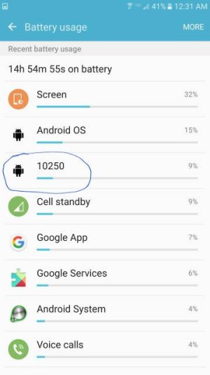

I don't really have any problem with my battery... But can anyone tell me what the 10250 in the battery consumption is about? First time I ever see it.

That could be an App UID, or user ID. The discussions below are older, but help provide some background details on App UID. For some reason, your phone's battery stats decided to show the App UID instead of the app's name. The way I'd think of this is that the app's IP address "192.168.0.1" was shown instead of it's friendly name "www.awebsite.org". The IP address and friendly DNS name are made up for this example.
Rebooting the phone may help clear that up. An app like GSam Battery Monitor will show the App UID in App Usage\App Detail. 10256 is the App UID for Flipboard on my Note 5. There may also be apps in Google Play that can query and list all App UIDs, or if you have a Terminal app installed, then that could be used to list out the App UID as suggested in the discussions below.
