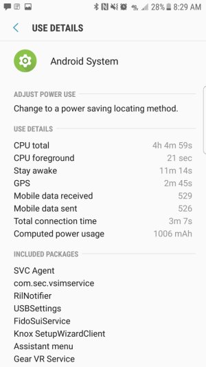

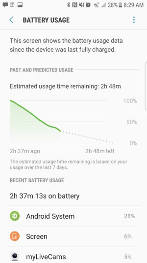

I upgraded about a week ago and every since my battery has been draining about 12% and hour just idle. I have tried multiple cache wipes, with no luck. When I check the battery usage, Android System is always at the top. My phone is warmer than usual and I think something is constantly using my CPU, but I have not idea what.

Wiping the cache and factory reset was a temp fix for me. I lost 17% overnight and just had to put my phone on charge. I'm getting ready to throw this thing in the ocean.
View attachment 253413 View attachment 253414
Dude, look at your signal. It's terrible.
