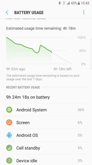

For some, including myself, my battery life has increased. 2 of the most common culprits is a weak signal and very high Android System usage. The high Android System usage can be fixed with a factory reset without doing a restore. I stress very much, without doing a restore.
If you have bad battery life after a reset and did not restore, then you installed an app that is the culprit, unless of course you have bad reception.

As you can see from my picture my Android System Usage is very high and is accounting for 37% of the battery drain. I'm working shifts until Thursday so will leave the phone as is until then, if there's no improvement by then I'll factory reset it.

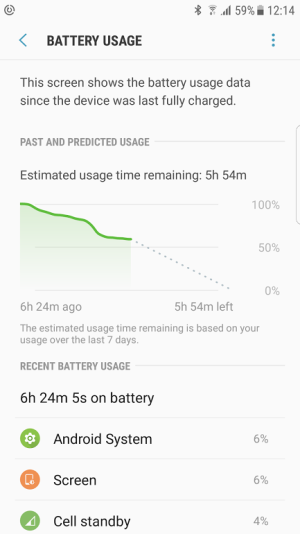

Finally bit the bullet and factory reset last night. Current battery stats for today are below, note I have been messing around a lot with my phone today trying to get it setup correctly following the factory reset. Also note how Android System drain has gone from 36% to 6%!!:

I'd like to see how your numbers look in Gsam over say an 8 hour period.. i've never been able to see android system that low, not even on a bare/wiped phone for some reason. My phone is the tmobile s7 edge.. maybe its something about this phone i dunno, but the best it can muster is about 2% loss when off when at work (poor signal), often more like 5 or 6%/hr.. and at night i've managed to get it to 1.2%/hr at home loss when off.. a typical 1 hour of SOT over 7 hours is about 5.7%/hr for me.. as good as i can get it, despite trying everything.
Under android system IMSservice is usually the biggest culprit
