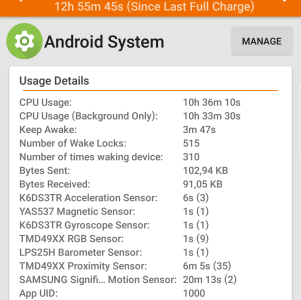

GSM is pretty worthless after Android 7 update. It can't differentiate as to what apps are causing drain anymore and just lumps everything under Combined App CPU. I ended up uninstalling it because of this.

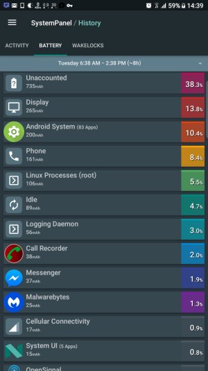

I don't know why they stupified the battery consumption percentages, but if you want better stats, one of the very best apps (IMHO) is System Panel 2.
You have to give it Usage Data Access and enable it in Accessibility, as well as use ADB to further enable it's monitoring abilities, but they've made this very easy - you just connect it to PC via USB and run their PC app, and suddenly the Android app can track exactly how much current an app or piece of hardware is using!

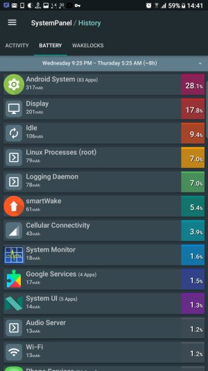

Here's a screenshot of mine.
I may be having more, than just one problem. In one of the attachments, the Android System battery consumption is absurd (28%). In another, 38.3% of total consumption is unaccounted for - the app can't determine what is draining the battery!
The third attachment shows the system's own battery consumption tracker, and "Android System" is at 31% with 10% of battery left to go. If I drained the battery to zero, "Android System" would have consumed 34%!
This is unacceptable, and the problem is obviously widespread. How could Samsung have overlooked something like that?

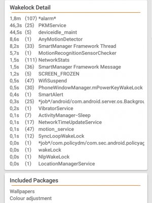

i decided to add GSAM to the mix, surprisingly it shows even more detail for the elusive "Android System" category...
Still doesn't tell me which of the 83 apps is doing what, but I does list the wakelocks and the sensors used, which can give you an idea.
But I still don't know, how to solve the problem...

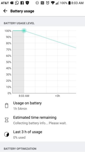

I know this forum is for the S7, but I am facing the same issue with a different phone and I believe the knowledgeable people in this forum might be able to help me. I have a LG LG X venture H700, when I got this phone (about 6 weeks ago), its battery lasted the whole day with heavy use and I still got to the end of the day with 40%+ left. Without changing anything at all, about 2 weeks ago (as I said, without changing anything at all) it started burning about 7%/hour in idle state. When I go to battery usage details, it shows Android System with high %. When I get to the details of Android, it shows "keep awake" with about the same time the phone has been unplugged from the charger. It looks like my phone doesn't go to sleep at all. Phone already came with nougat. Appreciate any help or suggestions. Emerson.

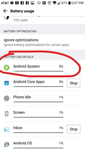

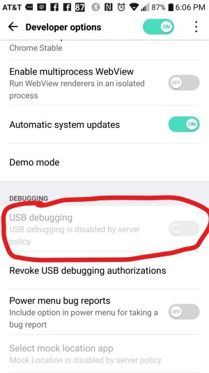

Thank you H8FKAndroid, it looks like i'm stuck with this for now. This is a company sponsored device, I can't change some settings, one of them is the "USB debugging" and as such I can't run Gsam or Systempanel2 at their fullest capabilities. I can't root the device either.
I will keep an eye at this conversation to see if someone will be able to com up with the solution, then maybe I will be able to apply it to LG as well.
Well maybe that's a good thing, because I assume someone at the company is responsible for them.
Perhaps you should turn to them with the problem?
But from your screenshots it seems Android System is only consuming 5%? If so, it's not the same problem.
Regardless, complain to the company about it not working properly...

Well, surprisingly this morning my phone decided to go back to what it was before (at least so far, hopefully I'm not speaking too soon). With almost 2 hours of very light use, about 20 minutes with screen on, checked and replied few emails and few whatsapp messages, see how battery is holding on. I did NOT change anything, I only installed Systempanel2 to try to understand better what was killing the battery, yesterday the phone was still very hungry, so it cannot be that the Systempanel2 helped in anyway.
Fingers crossed it will stat this way. Usually by now, almost 2 hours after I unplugged it from the charger, at least 10% would have gone for sure.

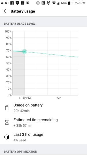

My phone came originally with nougat. It worked great for few weeks, then for about one week it started training the battery like crazy, then out of the blue decided to go back to "normal". It has been working normally again for about a week, so I assume this will be my last post, I hope you guys can find a solution for the S7 and others as well. See below a recent screenshot. This is with light use. With heavy use I get to the end of the day with 40%+ left. I'm happy again with how the battery is holding on the whole day (or more).
