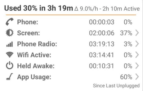

Just to show some WiFi use, this was the kind of result I was getting on mobile on MM. About 2hrs SOT per 30% battery.

App usage. Note the high usage of system, not shown on GSAM pre Nougat. I'm unsure if this is a more accurate reading as there was a mandatory use of ADB to be able to see (give permission) individual app usage.

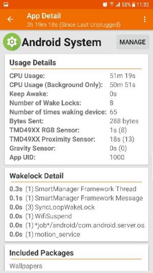

And System info. The wakelocks are very low compared to me periodically checking yesterday. *alarm* would've had near 200 wakelocks by now, but it's not even listed in the wakelock detail sectikn. Unsure what I've changed, if anything.

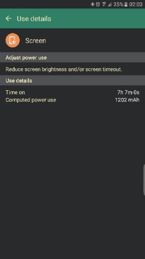

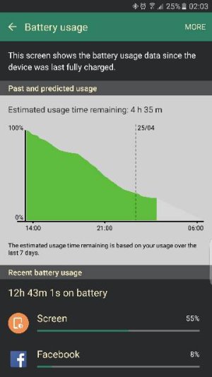

This is me yesterday
Overall
SOT and still had over 25% battery left
Wow, pretty outstanding. Care to tell us you radio settings, internet usage type and other settings such as screen brightness?

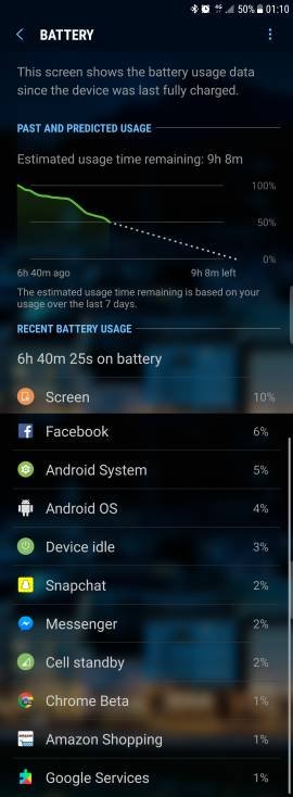

Here's what my bar is sitting at:
Here are the apps I have disabled:
I hope this helps.
I fully believe being mostly on WiFi is really what helps, otherwise I don't use Power Saving and I set my Display to WQHD as FHD really didn't make a difference.
