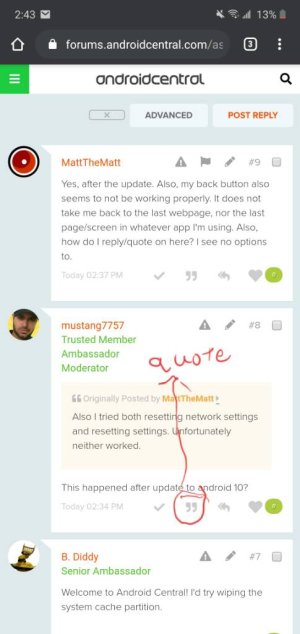

Yes, after the update. Also, my back button also seems to not be working properly. It does not take me back to the last webpage, nor the last page/screen in whatever app I'm using. Also, how do I reply/quote on here? I see no options to.
