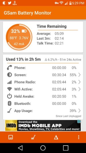

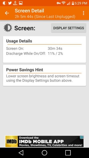

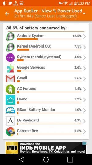

Ok, so it's only been 2 hours but here is where I'm at.
Over those 2 hours I averaged about 10 minutes/hour for held awake but more importantly the phone only used 2% of the battery when the screen was off which would be 1%/hour.
I will keep it installed at least thru another charge cycle and post more info.
After obsessing over battery stats for a while I've definitely settled into loving the performance I'm getting and I've stopped monitoring so much.
Having said that, I'm happy to help in any way even if it means monitoring things for a day or two.

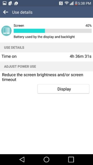

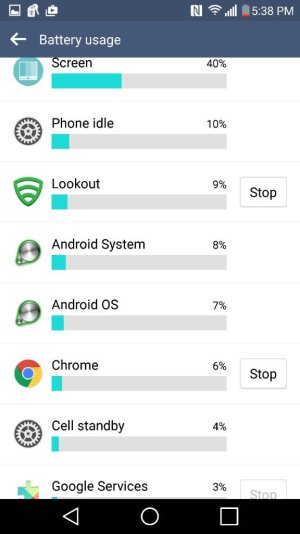

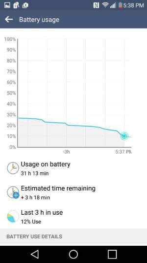

Well, right now I am at over 31 hours usage, and at nearly 4 hours 40 minutes of SOT (still using without charging posting this), with 10% battery remaining. Very satisfied!

That's simply amazing to me. We're worlds apart in battery performance with the same phone. May I ask, when your screen is on, what your activity is on your phone? When my screen is on, I'm pretty much always playing words with friends, or browsing. The only way I could get your SOT numbers would be to set the phone display to always on and put the phone down.
During that time, I am surfing the web, Facebook, watching some videos (usually over WiFi for videos), texting, picture taking and editing, using this app plus the eBay app.
I keep my brightness in Auto, plus I have disabled the Google services I do not use, set my email to sync only hourly.
With lots of use, I can hit 7 hours SOT with over 16 hours usage (have done this many times). Love the battery life!
