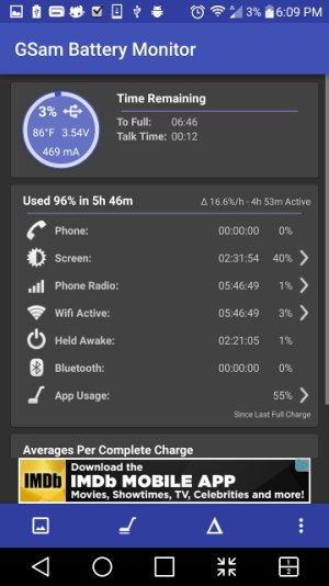

I can't tell if location history off is making a difference. I still am only getting 12 hours +/- 1 hour from a full charge with 2 or 2.5 hours of screen on time. My daily routine is so constant that anything that improves things, like the change to brightness, will show up in the data. I think a different approach is needed. I'm going to uninstall home depot app and see if anything changes. Screenshots for today are at the bottom of this post for reference. I'm not sure how the notification drawer ended up in some of them.

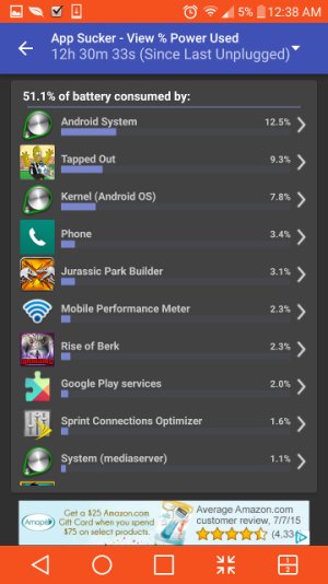

What about that second app "mobile performance meter"? I looked it up and it appears to be a shopping rewards app - that may be relying on GPS, network, etc. Looks like its doing a lot to keep your phone awake.

It is a device and network performance analysis thing. But yes it rewards you with points you redeem for gift cards. I used it for two years on my previous device (galaxy S4) and it had no battery foot print at all. Which is why I think it has gone rogue. I may very well have to uninstall it too. Which would be a shame as I would have to contact support and go through a lot of trouble to get everything back correctly. I could contact support and see what they recommend in response to telling them the thing is massively draining the battery.

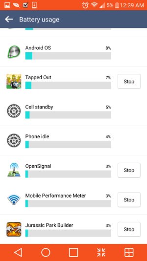

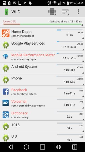

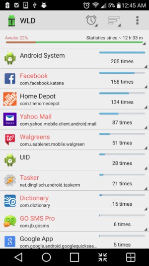

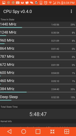

1-gsam1.jpg2-gsam2.jpg3-batstat1.jpg4-batstat2.jpg5-wakelock1.jpg6-wakelock2.jpg7-cpuspy.jpg

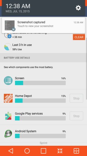

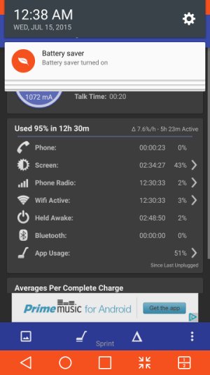

I'm about to flip out as this is getting crazy. Uninstalled home depot last night and rebooted this morning and then unplugged the charger. And somehow things got worse. Now it didn't even deep sleep for nearly the whole time since unplugging the charger. just over 5 hours uptime, 2.5 hours screen on time, and battery at 5% left. One day lost to see what the impact the home depot app had. Seems the home depot devs replied to others reporting massive battery drain with exit and restart the app. That of course did nothing in my case. I'm going to contact mobile performance meter to inquire about getting my account restored after removing the app to prep for uninstalling it as well. Hopefully tomorrow what happened today won't happen so I can finally have peace from a reliable at least a full days battery.

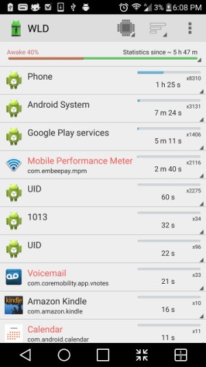

If you think it will help. I'm writing today off as a bad day. Here are a few showing the details. Wake counts went up drastically in phone and UID (unidentified system process) and went down drastically in google play services and mobile performance meter.

Is it normal for you to be roaming? I notice in these shots you are.
Roaming is way out of the ordinary. There are plenty of sprint towers around my house. Which is where I took the screenshots from. I was a little late getting on the charger and it auto shut down on me. I assume if there was a way to see how long it had been roaming that probably got messed up from that.

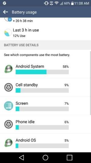

My battery life is not improving no matter what tweaks I do. My cell standby was insanely high so I put on WiFi calling. Now my Android system is high. I think a factory reset is in order.

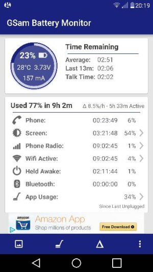

I don't see the how long you've been on battery in the screenshots but I do see an estimated 20 hours remaining with 60% battery left. That's nothing to be dismayed about. Out of box I was lucky to see 12 hours out of a full charge.

There is a thread titled Wake lock detector works on the G4 (no root required) on here I found. Most of the info needed to do it is in WLDs guide linked to in the apps description in google play store. This may very well help you identify what is waking your G4. It helped me identify three things. If it is google play services be sure to follow the recommendations in this thread for it.
