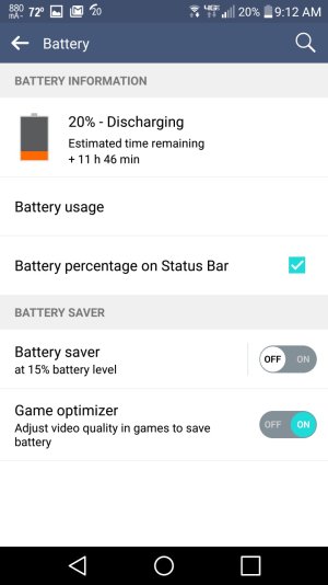

Yesterday I had a photography class, and I had a DSLR and my LG G4. I used my G4 more, but I traded off every once in a while. I got 7 hours of usage off of the battery, 198 pictures in Manual mode (mostly outdoors) with GPS always on to tag the images and brightness up. I got 2+ hours of SOT, which doesn't sound like a lot, but I imagine that imaging sensors take up a lot of battery, especially when it's always open, and playing with it.
Here are some screenshots.
Screenshot_2015-07-11-15-13-34.jpgScreenshot_2015-07-11-15-13-37.jpgScreenshot_2015-07-11-15-13-41.jpgScreenshot_2015-07-11-15-13-46.jpgScreenshot_2015-07-11-15-13-53.jpg

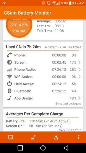

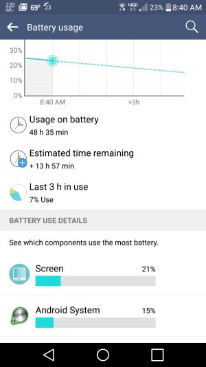

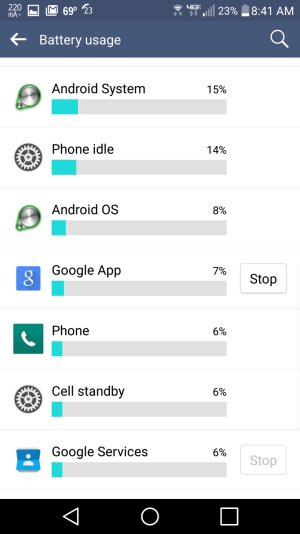

OK, so I think I may have set a small record with battery life this weekend.... 48hrs! NOW, my use this weekend has been fairly atypical as I have been afflicted with bilateral kidney stones and have been in bed most of the time and my phone use habits have varied a bit from my norm. While my screen on time is just over two hours, I have been streaming a lot of music from Pandora. I've also been keeping up with things on G+ and FB. It started friday night when I was in so much pain I left my phone on the bedside table without plugging it in then I just decided to stretch it out as long as I could to see how long it would last.

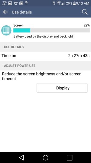

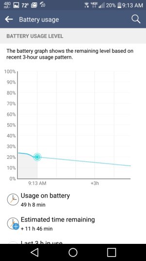

Stats: Battery #2 - from the LG promotion, WiFi and location on. Screen at 42% brightness. As posted in another thread, I had cleared the Google play services app cache and memory on friday so I think that had a lot to do with it. GP services is running at under 10%.
Screenshot_2015-07-12-08-40-53.jpgScreenshot_2015-07-12-08-41-03.jpgScreenshot_2015-07-12-09-12-53.jpgScreenshot_2015-07-12-09-13-17.jpgScreenshot_2015-07-12-09-13-30.jpg
David

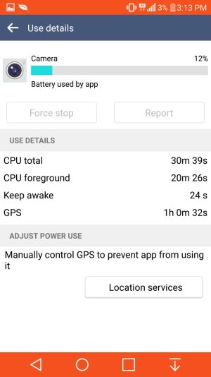

Without changing anything else at this time and only going to manual control of brightness to find the brightness levels with my tasker brightness control active I can already tell this will reduce the battery consumed by the screen; running math on the battery consumption from today compared to yesterday indicates a possible 25% reduction. But that might be an overestimation. I assume setting brightness at the lowest possible level (comfortable without having to strain to see) for each ambient light scenario I regularly use my G4 in is the best savings I can hope to get from the screen. If so then I'm satisfied to move on to tracking down the battery wasters. I'm starting with turning of location history. None of my previous phones had that setting and seems a logical place to start. So for tomorrow I'll be using todays change: tasker controlled brightness and location history off.

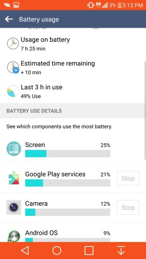

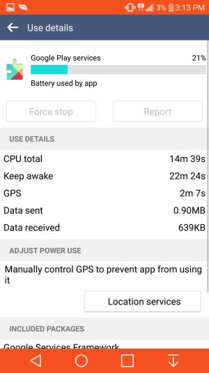

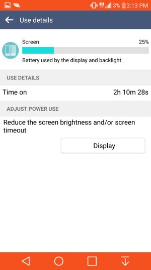

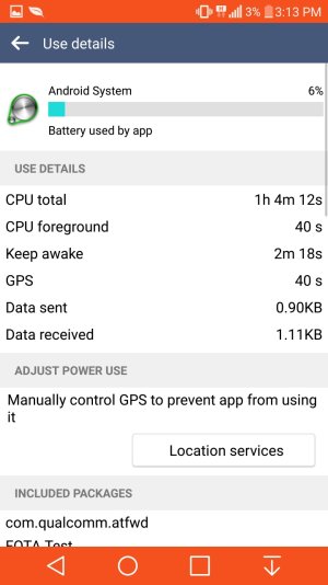

I'm down to 40% battery left with being unplugged for 7 hours and having had 13 minutes of screen time. Android Services has used about 22% of my battery. I'm not sure what else I can do, but I would love any suggestions.
I've turned off Location History and gone through and turned off Keep Awake for every app that show up under Access Lock. It's odd that none of the Google apps show up in that app list. I only have Gmail, Calendar and Contact syncing (I need those). I did read a post above this one where someone talked about disabling Google Now. I really like Google Now, but I'll try disabling it except that I can't find anywhere to do that. Anybody know how?
Anyway, I love this phone, but would really like more up time on the battery. Suggestions are appreciated.
Go into application manager and ALL Apps, scroll down to Google Play Services then Manage Space. Clear All Data. If you have an option to uninstall Updates (some do, some dont), do that too and restart.
Since doing that, I have made it to 50 hours without turning off and almost 3 hours SOT (40% brightness with auto off). On this latest charge, I am currently at 30 hours with 3 hrs SOT with 22% remaining on my battery. WiFi, Location High Accuracy are all turned on too. Email sync is turned off - I manually Sync
Google Play Services is running at 10% or less now.

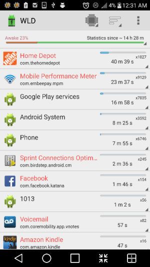

I just discovered I was doing something wrong with wakelock detector the last few days. Which resulted in me not seeing some things. Today home depot and mobile performance meter appear to have gone rogue again. Google play services, android system, and phone have a wake count combined of over 17,000. Something definitely is out of whack with that. I'm going to have to leave everything the same for tomorrow to get good data on having location history off. Rebooting in the morning hopefully there won't be any rogue apps.
I wonder if the same app or apps are to blame for all the issues. I've pointed out before that my high Android OS awake times were the result of the Fenix app for Twitter apparently having gone rogue (as it isn't widely attributed to be a bad app). Yet, the Fenix stats themselves didn't really suggest any problem, which is what made figuring it out such a pain (I couldn't get Wakelock Detector to work or maybe it wouldn't have been).
In your case, maybe you have a variation of that, where your apps are causing issues in other apps, but also in their own app info. Just a thought.
Does the Home Depot app have a Find A Store feature? It could be constantly looking for one using Location options.
