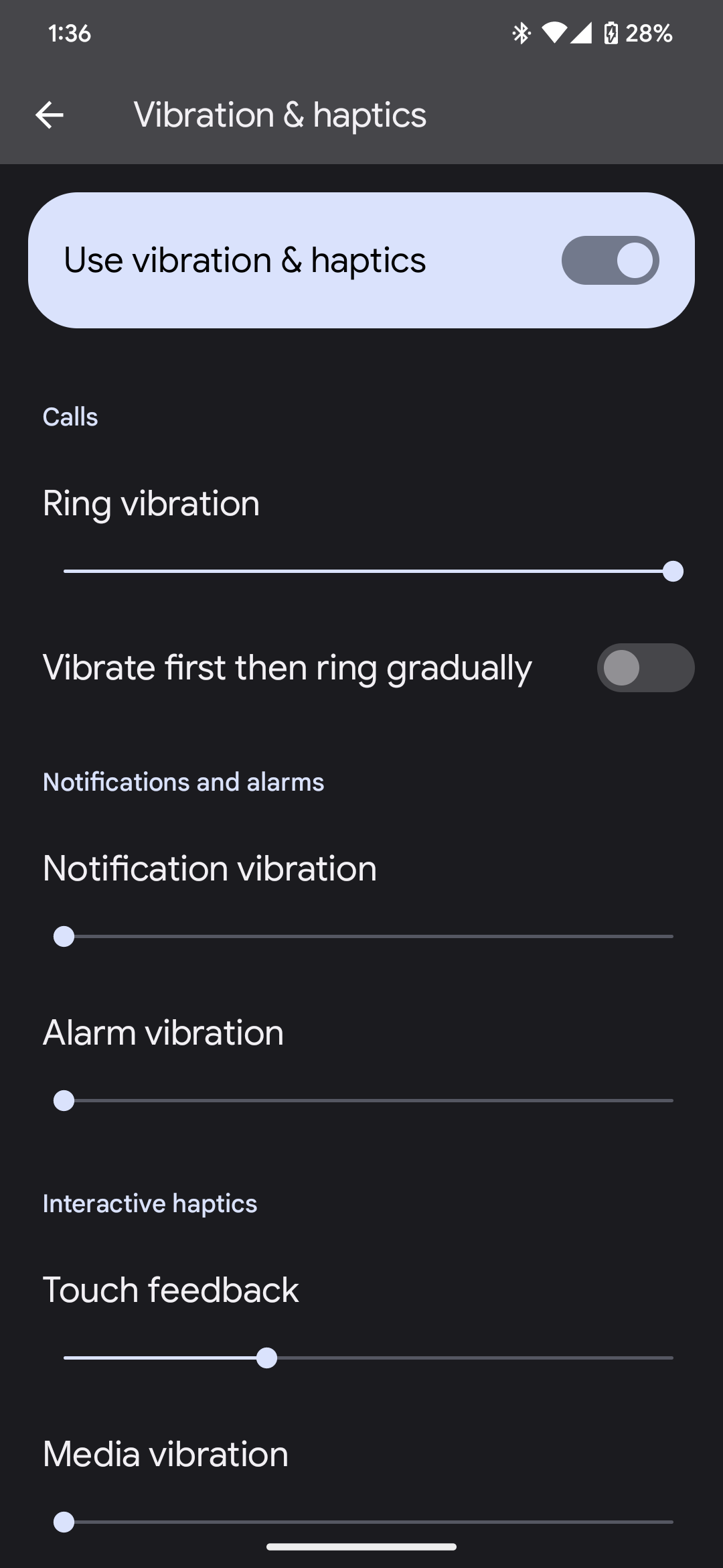

Settings>sounds and vibration>vibration and haptics
Sent from my Pixel 7 Pro using Tapatalk
Ring vibration calls top slide bar

Yeah so in the volume mode selection ring/vibration/silent under ring it will vibrate under vibration selection it wont vibrate if you turn the vibration slider all the way down on ring for calls as in my screenshot
That's correct. If you turn the vibration slider off for ringing, that eliminates the vibration when the ringer is on, but if you then toggle to vibrate it won't vibrate because that slider is off. Try it and I bet yours does the same. I looked on Google's help and it says to turn "vibrate while ringing" off to fix this, but I (and I bet others) don't have this setting.
Yeah your right with slider off and in vibration selection it doesn't vibrate
Ok main thing here is vibration selection mode and slider for vibration off no vibration, think that was the confusion
