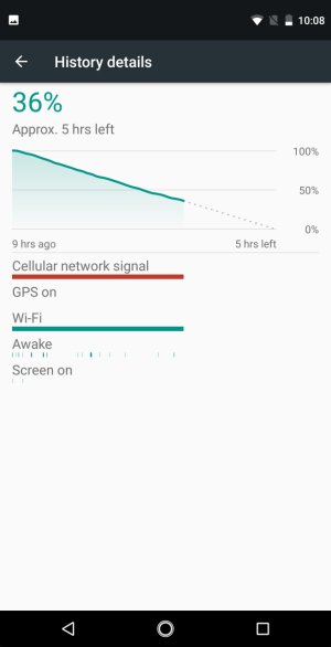

I'm getting horrible battery life, nothing like what has been posted here.
How many mAh are reported for Phone idle, Waze, Screen, Cell standby, Google Services and Android OS? Click on each one to get the number.
Do you have any social media apps burning in the background?
The fact that your slope is a straight line is odd. Something looks to be causing a constant drain. You should see a big dip while Waze was in use but it should level out once the app was closed. Or, did you leave Waze open all day?
That's what I thought too (although honestly I've never spent much time looking or investigating battery use/drain on Android).
No, just during my commute. It's on WiFi all day at my office.

I uninstalled Messenger, put the phone in airplane mode and 6 hours later it's down 50% with no use at all. Something is seriously wrong. Same slope on the battery use. I'm going to factory reset the phone and see if it's any different. It's not worth the $399 I paid if I can't get 12 hours out of the device.
@mkreef It's either your apps (or an app) or you somehow ended up with a defective battery. Software is more likely so a factory reset is a good idea. I've had four PH-1s so far and all last forever on a full charge.
That's good to know. Is safe mode sufficient to rule out the apps? Before I factory reset, I'm trying safe mode and not touching the phone -- the battery has dropped 10% in a little more than 1 hour.
I've never tried safe mode to know what gets disabled. It's worth a try. 10% per hour sounds like a lot. I'd turn off radios as well just to see if poor signal in your area is causing high amounts of scanning and radio use.

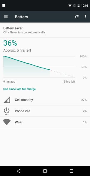

FWIW, I removed my sim, did a factory reset, setup as a new device, not even with my google account, installed zero apps, made sure phone was fully charged. I'm seeing almost the identical battery usage. Looks like 13 hours (whereas I was getting 12 with cellular radios and poor Verizon signal), identical battery usage slope. Only two apps listed are Cell standby (15%) and Phone idle (1%). I only pick up the phone once an hour to check battery level.
So something is seriously wrong with this. I’m going to take it back to BestBuy and try for an exchange (I paid $400 and if I can get a days worth out of the battery I will keep it).
How many mAh are you seeing on the Cell Standby? It might be worth getting a replacement either way. At least that way you'll know.
Factory reset, no sim card, no apps installed, no google account associated with phone -- just connected to WiFi. Not sure I understand why Cell standby uses so much power when there is no sim card.
Cell standby 832mAh
Phone Idle 73mAh
WiFi 18mAh
