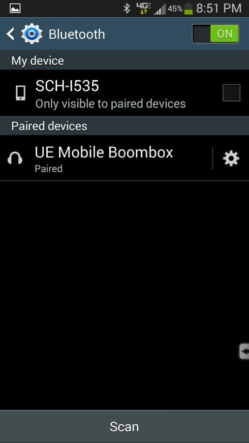

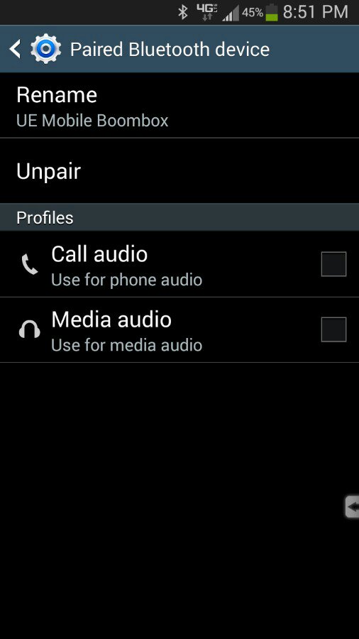

had similar problem: shut off "media audio" setting to my Bluetooth... phone started ringing immediately when a call came in, (using Plantronics Voyager Pro Bluetooth.)
I can't seem to find "media audio" anywhere. My S4 just started doing this yesterday and it is my business phone so I really need a quick fix.
Any help would be greatly appreciated.
Once you have Bluetooth enabled you'll see a list of your paired devices.
Tap the gear icon next to the device you want to manage and you'll see the various profile parameters that you can enable/disable.
Sent from my rooted, debloated, deodexed Sinclair ZX-80 running CM -0.001 using Tapatalk
