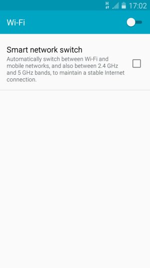

I remember reading that some people had problems with the Smart Mode and Smart Switch. Take a look in the settings and switch them off just on case.
I'm not sure what you mean by smart mode/smart switch. I doubt you mean the content transfer app that samsung uses, and I also don't have it installed.
Do you mean the network switch option? In which case, I've actually tried turning on wifi with that toggled on and off, and it seems to make no difference. It didn't hurt to try though, you're right.
My idea was to switch off any possible WiFi optimiser in your phone. There's the stock one in your settings - WiFi - advanced. Some Samsung phones come with an special feature and even some carriers implement a different one. Most of them are called Smart something and I've read people having problems with all of them.
Yeah, unfortunately I'm not sure that one makes a difference. Should I just be taking it down to a shop?
