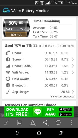

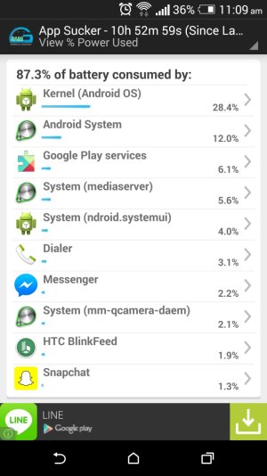

My HTC One M8 dies in just about 12h-15h with screen on time of 3h-4h. It is connected to Wi-Fi network 90% of the time and I don't use a cellular data connection. Auto-Sync is on. Screen brightness is either 25% or 50% in direct sunlight. I am on stock 4.4.4 Rom software number 3.28.401.9
I haven't came across any other M8s so I don't know if the issue is just with my phone. But my roommate has a Xperia Z1 and a friend has SGS4 both get around 30h of battery life with moderate to high use. The standby time is also not so good because I lose about 15%-25% battery in about 3h-4h everyday when I wake up in the morning. I've tried factory resetting my phone thrice but to no avail. I've installed GSAM and included the screenshots. I want to know if its normal and if not what can I do? Would re-flashing the firmware help? If yes how can I flash stock firmware?
The amount of power the kernel will draw is mainly dependent on the CPU clock speed. Are you running it overclocked?
Comparing the amount of time a battery lasts between 2 totally different phones is like comparing the gas mileage between a Chevy SUV and a Porsche.
If the phone isn't being overclocked, I'd see if they'd exchange it. 28% isn't outrageous, but it sounds a bit higher than "just a bit high".

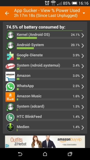

Same problem to me. I also tried wiping the cache partition, even a factory reset didn't help. Android kernel and system are still the top 2 batterie suckers...
I don't know what else to try...
