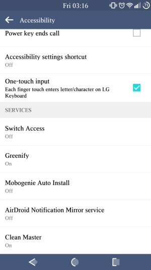

I've been using Mobogenie for a few years and thought it was really nice. Lots of free apps that sometimes cost money on Google Play.
Then yesterday it offered me to activate auto install and asked for superuser permission. I confirmed but luckily didn't switch on in Accessibility settings. Then suddenly when I picked up the phone later there was an installation screen for an app which I cancelled, followed by another one and another one... There were around 8 apps, among them Apus launcher, DU Speed Booster, CM Security, Omniswipe and more.
Did a cleanmaster scan and it found all the unused apk's so I could delete them.
A really dirty and stupid move by Mobogenie.
