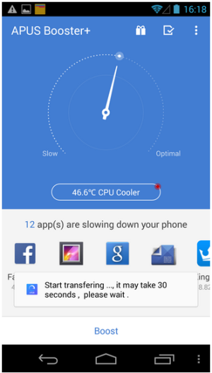

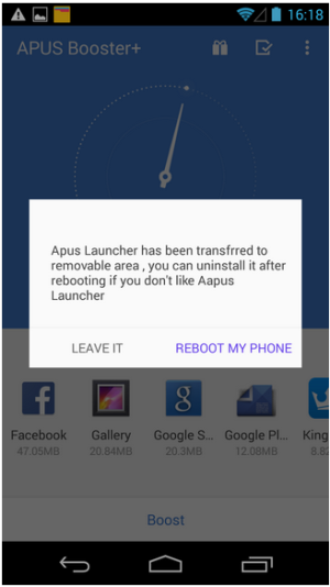

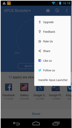

We're sorry to hear that our app also was a part of this "black" promotion.
Our developers made a tool to fix this problem and delete this unofficial APUS Launcher with all ads.
Here is an instruction:
Instruction
The tool's apk is attached, and please follow instructions below to perform the uninstallation. 1. Make sure your phone is rooted, and please also grant root access permission to this tool 2. Download the apk from this email's attachment and install it 3. Open up the app (Booster+) 4. Tap the 3-dots icon on top right corner 5. Select "Transfer APUS Launcher", then wait up to 30 seconds 6. A window will pop up, tap reboot. 7. After rebooting your phone, you should be able to uninstall APUS Launcher. Attached 3 screenshots to make the process clearer. Please note that you will only be able to see the "Transfer APUS Launcher" option if you have the unofficial version of APUS Launcher (forcefully) installed on your phone. We hope this can solve the problem, please let us know if you encounter any issues. Thank you. Looking forward to hearing from you soon.
If you have any questions, you can send us to help [at] apussupport [dot] com
