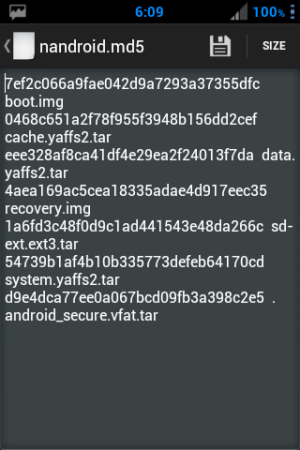

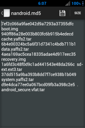

Question. I made 2 backups of this rom, is there any way to check the Md5 sum of a backup? I tried with Scary Alien app, it said that i couldn't check it? Any ideas?

Download ES File Explorer (it is now the best root file explorer out there).
Go to /sdcard/clockworkmod/backup/(name of backup folder)/nandroid.md5
Tap on it. Select Text option. Select ES Note Editor.
It will now display the md5 sum for the boot and the recovery images.

Thanks andy, didn't have much time, but what i found from Google, there are a plethora of people that get a Md5 sum mismatch when trying to restore a backup that was made threw clockworkmod recovery!
From what i read there's a way to fix it using adb, i'll have to do a little more research on this cause last time i restored backup of CMX Rom i got a Md5 sum mismatch.
Just delete everything in the nandroid.md5 but the boot and recovery md5sums.
I think its the extra stuff it might have put in there that's giving you the miss matched error.

These are both backups of this rom andy, i see what you mean about all the other md5 sums, although my good backup of MiRaGe looks like that too.
I don't mean to doubt what you say, but are you sure that i can delete all the md5 sums except boot.zip and recovery.zip?
I just want to make sure that i have a backup left, just in case.
Thanks. :)
