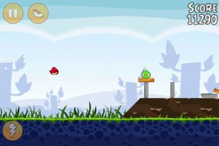

Re: [ROM+Kernel][CM-11.0][4.4.4][OS2SD/internal]bigsuperROM-thunderc-4.4.4
Works just fine.
