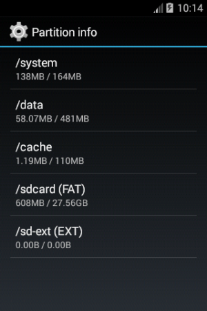

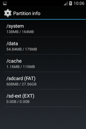

Re: [ROM+Kernel][CM-11.0][4.4.4][OS2SD/internal]bigsuperROM-thunderc-4.4.4
I just piddled with the int2extv2, update-binary incompatible with twrp, updater-script incompatible with ROM update-binary, dataswap thing that freezes up flashing... fix those, takes a fresh install clean boot, then recovery and flash the script, then there's a bunch of permissions problems after boot.
so far.
Ok, int2ext issue is selinux. Go figure.
fix it:
wipe everything in recovery but sd card. system, data, cache, sd-ext.
install rom, install linaro gcc 4.7 kernel from kernel archive since it doesn't have selinux enabled.
clean boot. reboot to recovery after clean boot. flash my tweaked int2extv2+ from the rom folder
and you should be good to go. Original here like dingermtb said.
If you all find it acceptable I'll add it to the OPs along with Toucan's internal to external thread.
