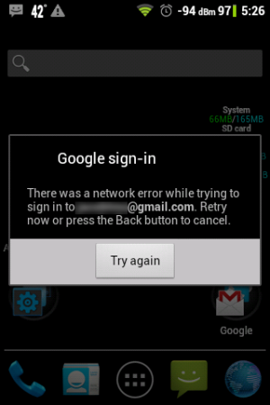

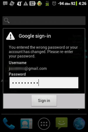

I'm having an authentication problem that just began--I'm not sure if it is related to the ROM--so, if you'd advise that the post be moved to a different section, by all means.
The phone keeps asking me to enter my password. I have a relatively high degree of certainty that I am entering it correctly-but it keeps popping up and asking me to re-enter.
Me Gmail, Google Voice, Calendar, Google+ all seem to sync fine. I can log on just fine on the computer.
I've never had any similar problem with my logon credentials in the past, so I don't know what's up.
I've logged into my Google account settings and verified everything--and checked that there have been no suspicious activities or compromises to my account.
For the specific details, see the attached images.
Has anybody else experienced this issue on the ROM or with the Cyanogenmod copy of Gapps?
Any input is appreciated.
Thanks!
Thanks!
Question: Did you check the MD5 sum of the Gapps.zip after downloading to make sure it didn't become corrupted?
Did you move the PlayStore to the SD card or use Link2SD to move it to the ext.4 partition?
What all did you wipe and format before installing the ROM and Gapps?
Yes. In fact, it's been working fine for some time now. This just occurred suddenly and unexpectedly.
No. Play is on the internal memory.
Cache, Dalvik, Data. Whatever it says on the instructions on the first page.
I think I've fixed the problem. I changed the password on my account, then deleted the cache for Google Services, then rebooted and re-entered my credentials.
So far, it seems to be working alright.
