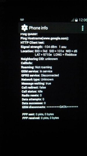

Was just poking around and did *#*#4636#*#* on the dialer. Anyone know if in other Roms it shows up as "gsm service: in service"
Sent from my XT907 using Tapatalk
This is le super normal. When I had stock froyo, it'd say in service. Its normal ;) its on every phone when in service.

dmesg sez, whether trying to enable or disable mobile data,
if it helps any.
jellybean dmesg only says rmnet0: no ipv6 routers present
when turning on.
but its logcat...
when it connects.
connectivity service and telephony manager look the big participants not playing nice in kitkat.
can you do an adb shell on kitkat, then run 'netcfg' with mobile data turned on? I'm interested in whether the line with rmnet0 says UP or DOWN and whether it shows an ip address. Also if rmnet0 shows DOWN try 'netcfg rmnet0 dhcp' (it may take a couple minutes to return).
Ok thanks for the info. I forgot to include in my previous post if this would help with the limited system partition space: http://androidforums.com/optimus-gt...600-easily-resize-system-data-partitions.html as this should allow you to resize it and I believe use space on the sdcard to give it more room. If so then you would be able to install the full gapps with no issues.
That would definitely help, we talked about this previously. I may upload a larger rom at some point for whoever wants to try this. If we can get some kind of link2sd script working we could take space from data and give it to system since all the apps would be going to sd-ext. But it looks like bigsupersquid's approach is going to work fine. We'll probably end up with several options for getting a full install.
