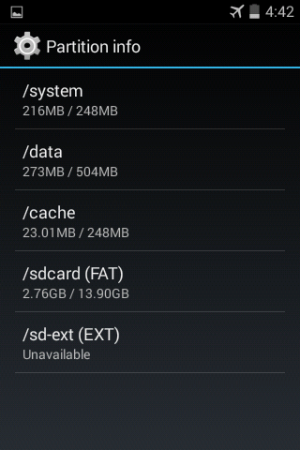

ok I'm rebuilding and testing with what you gave me, may try other config later. I'm looking at getting around an apparent permission problem with cache.
Edit: well it didn't break anything, logging into google now.
Edit: Partition info shows correct /data partition size :)
Edit: cache is working. I'd call that a success :)
I think the fstab bit from hammerhead may be important, its sets all kind of flags on mount for the main directories. my earlier guesses, were really just that. guesses, at how it might work.

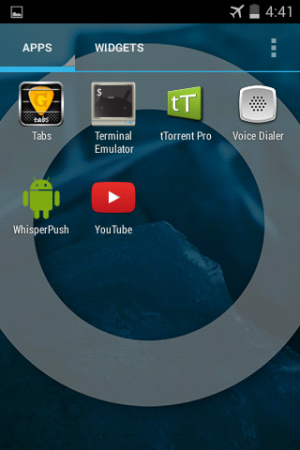

After using this setup for a while, I'd say it seems to be working great, although it's slower than normal with my class 4 card. I ordered the latest UHS-1 card that's supposed to be super fast so hopefully that should remedy the speed issue. Many many thanks bigsupersquid! This makes all the difference.
