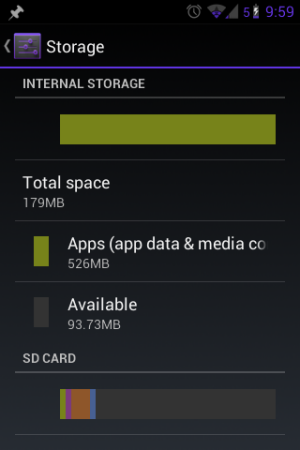

I do have some data issues. If I am on wifi for a while and the try to go back to 3g, 3g doesn't turn back on. I have found that if I keep mobile data off, and only turn it on when I want to use it, it is usually there. I added "toggle mobile data" to the power widget, so it's an easy enough workaround. Also a2sd++ is working well for me, pasted into init.d. I had about 40mb free before, now 177. I installed 22 apps from the play store, no fc.
