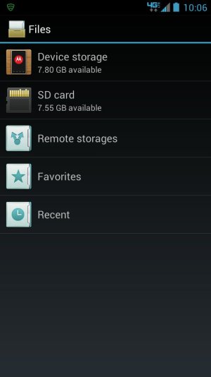

Any tips if I don't have 'remote storage' on my phone? Developer Options - USB Debugging is checked. Under Files I have Device storage, SD card, Favorites, and Recent. Am I missing a check box somewhere? Thanks.
Remote storage comes with your system file explorer. When you go into files it should look like this. If you don't have remote storages I would suggest getting an app like AndSMB or samba server from the play store. Both are free.

What version are you using (ICS or JB)? Once you type ifconfig look at the device that is wireless...than set your phone as shown...if you do not see the remote storage under files you need to update to JB first.
