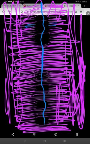

So I think my digitizer is messed up. I have no issues with my finger on the screen but when i go to write on the screen I noticed one spot that wasn't working.
See attached I never took my pen off the screen and color all over. in the spots in the middle where you see the blue line I had to press really hard. Also if you see the curve like at the top of the pink those were straight lines. I was wondering if anyone else would try this on a black background to see if your does the same.

Magnetic case... that was the cause. I guess this is good to have here in case anyone else has this issue.

Magnetic... I have tried two different cases from Amazon. Both cause issues for the S-pen at various locations on the screen. once I remove the tablet from the case, the problem disappears.
Yes magnetic.... I like it and still use it. But if I need to take notes I can remove it. Much easier than the OEM case.

Yeah definitely , what made u think the case ? It happened right after you installed it
Interesting, especially since I just got the Samsung book cover and it uses magnets. But I tried scribbling all over the screen like the OP and had no problems.

The Keyboard case is fine since it doesn't use magnets. My problem was with a aftermarket magnetic book cover style case. Works great except the area right in the middle. From what rfortson says the factory book cover case uses magnets and doesn't have the issue. For a $40 price difference I will just pull the case off when I want to take notes.
