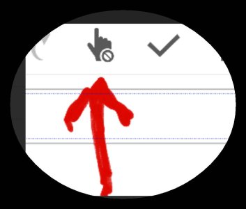

For your first question that is only available as an option in certain apps, like S Note or LectureNotes, etc. In S Note for instance you click the hand icon at the bottom of the screen to prevent hand touches from writing.
The second question has two answers. The one that will work everywhere is the stock keyboard. Long press the mic icon and choose the icon with a pen. You can have the handwriting mode automatically pop up by setting this in your keyboard settings as well. The second option is direct pen input which you enable under S Pen settings. This will not work everywhere but where it does work you will see a pen icon when hovering over a text field. Press that and an input box will pop up.
This is what the icon looks like in s-note
