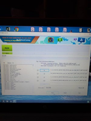

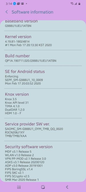

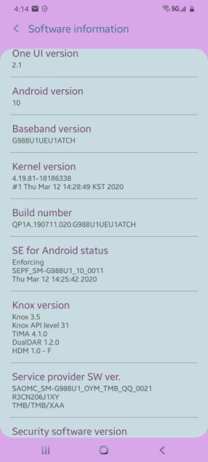

I have unlocked S20 ultra on t mobile. I took out my sim. I used ATT files posted.
Used prince Odin v3 it ran said passed.
But when I looked at phone it did not update. What happened?20200324_151303.jpegScreenshot_20200324-151413_Settings.jpeg
I tried again same files but with Odin3 v3.13.1B and it worked. Success.
