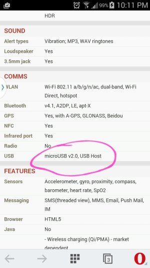

So, just curious, you are using a 2.0 adapter to a 3.0 adapter to use a 3.0 cable, like i use for my note3 ?
It's a regular Micro USB 3.0 mhl adapter.. New tech from Sammy.. Trust me it blew our minds when we first saw this also being like a 2.0 micro USB cable
Not new tech, USB 1.1, USB 2.0 works on USB 3.0 too., since USB 3.0 is backward compatible with older USB interface.
So your not using an adapter, but you are using a 3.0 cable?
It's USB 2.0 as the communications pipe, but MHL 3.0 as the data being sent over that pipe. The MHL 3.0 adapter has a USB 2.0 plug to go into the phone.
It's like you're confusing snow tires with 15" tires. The USB version and the MHL version are totally different things.
