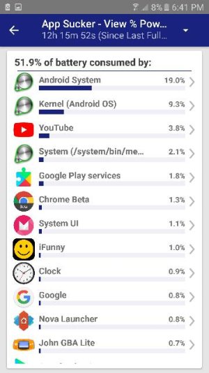

My galaxy S7 screen on battery life is horrendous. The standby is fine, but it just drops with the screen on. I always keep battery saver mode on, and I have had this problem for a while, but never as bad as this. Any advice? Here are some screenshots
View attachment 267615View attachment 26761621371.jpgView attachment 267617
(The wifi active drain is strange because I didn't have wifi on for most of the day)

1. Looks like you're not updated. On the latest update, the power saving icon should be on the left as it's now a systrm setting.
2. How old is the device?
3. Your signal is horrendous. I would expect subpar battery life in those conditions. The worse the signal, the worse the battery life.

3:I actully think that might be it because I just took a 2 hour trip and the signal was great the whole time, and I was really surprised but the good battery life. But does the signal drain happen when wifi is turned on?

Wifi has nothing to do with the battery drain from low signal. Low signal, bad battery. The phone will use up a lot of power trying to keep the connection.
