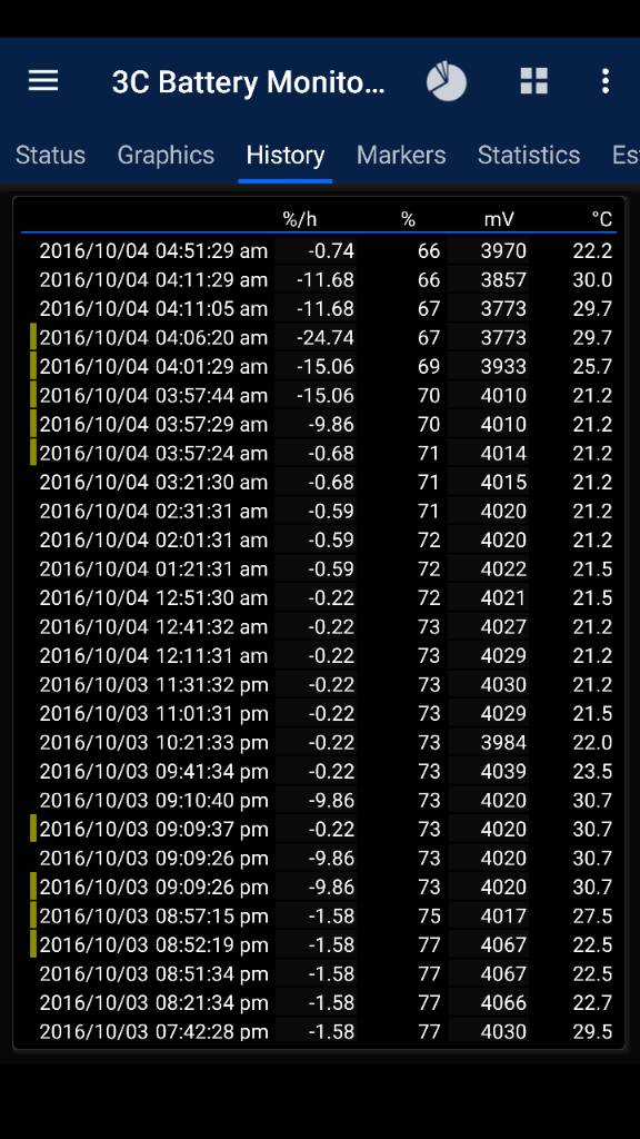

3C has a cool chart... Granular stats

Thanks ill give this a shot as well.. i had been looking for something that showed the hour by hour granularity like an app i had on iphone before.. that should fit the bill.
