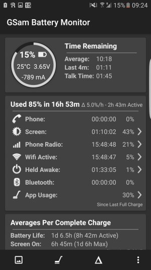

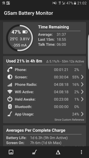

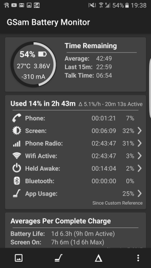

My s7 drains when sitting idle on the table drains about 5% per hour and about 10 % per hour if browsing and 17 % if on youtube.
Factory reset (with no new apps installed - except gsam), still shows 5 % drain per hour when phone is just sitting idle. GSAM doesn't show anything strange except the fact the per hour drain when screen is off is still quite high.
when i first got it (less than a month ago) over night was only about 4-6 percent drainage now it is up to around 30 % per night!

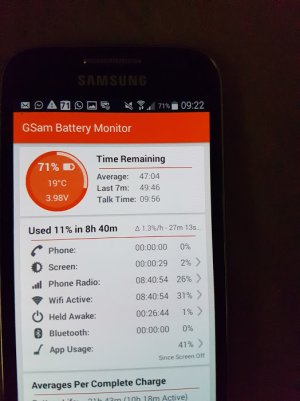

My wifes s4 mini drains around 1 % per hour when phone is just idle sitting on table while s7 edge drains about 5% per hour and easily outlasts my s7 edge it is a disgrace ! for 700$+ phone
Has anyone solved this problem successfully ?
Surely there must be someone who as solved it or got it fixed or returned ?
The orange gsam photo is for s4 mini the others for s7 edge (pls notice the screen on time in both)

What happened at the end did you manage to solve the battery drain?
