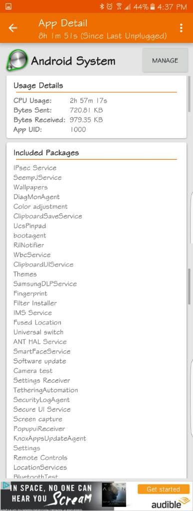

Basically like in the title..
I have the s7 edge tmobile version (32GB).. running nova and i do have quite a few things installed.
I typically use Gsam to monitor drain.. i'm seeing anywhere from 15-25% drain with just the screen on (and/or browsing facebook, the web, emails), which seems ridiculous to me.
I've tried disabling things in package disabler to no avail.
Its hard to pinpoint a culprit using gsam.. i also try using the wakelock detector app but i'm not rooted so its not much use. (not wanting to root, because i hear you have to jump through hoops to make certain things work and also may have more battery drain).
Conversly.. Typically when i view the phone after its been off, ill see 3-5% while its turned off per hour.. in one hour the phone might wake up 25% of that time, say 15 minutes maybe 20.. this is on a good day.

I think the app drain is typical, per some shots in this thread from the 3d battery widget app.. you can see 12-15% for generic usage.. and after comparing with some reports from an iphone 6s plus, it sounds as if that level of drain is par..
Whats not so par is the off drain.. granted in my case i have a lot of background tasking going on, keeping it from deep sleep id say.. using 3c, i can see an average of 1.8-3% when its off and been off for awhile.
I can bring it down by 0.5% per hour by turning off the active display and edge features.. of course i could put it in airplane mode and it would barely drain while off at all.
It seems to impossible a task to try to determine what is causing the drain, though things seem to point to the "android os" as being the biggest sucker of battery (common in a lot of threads out there).
I also use adoptable storage (64gb sd card u3 etc).. not sure if thats a factor.
Its either disable half of what makes the phone useful and get better standby life, or live with a 2-3% (best case scenario) drain while off in my case, is my thinking.
