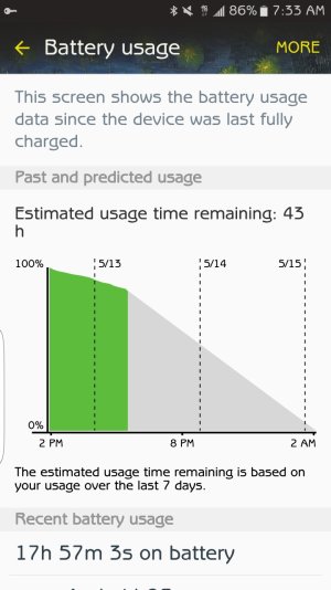

Decided to leave mine alone for a couple of hours after a full charge this morning to see the drain.
Time off charge 2h18, Stay Awake 2h15, battery remaining 81%.

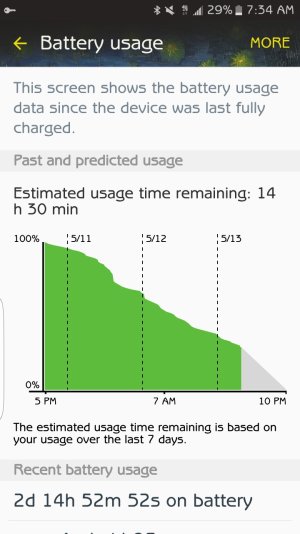

I don't think that this has as big an effect on battery life as people think it does. I have two S7 Edge phones. I haven't been using them much the last two weeks because I'm using a Note 4 and a Note Edge as my daily phones. Standby times on the S7 Edge phones have been between 2-3+ days with about an hour of screen time. Both have T-Mobile sims in them.

FWIW, I don't have any of these disabled, and I can get 2+ days of use out of mine with around 5-6 hours sot with always on disabled. Always on reduces that by about 25% for me. That's on par with my lumia 1520 which has a higher endurance rating listed on gsmarena.
Not saying these aren't power hungry apps, but it shouldn't be a requirement to good battery life.
