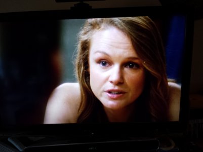

Somebody else had a issue in another thread about video quality, from what happen to them it was the fact that the Chromecast was on the otherside of the house from where the router was located. It worked fine on TVs closer to the router.
Also for further testing I just tried out my wife's laptop. It has only an i3-2348m processor and had no issues pushing 720p content. I did both Youtube and Netflix.
The rest of her laptop stats are Windows 8 64 bit and 4gb of ram.

No, YouTube and Netflix are fine. They actually come in at 1080p without any problem. It is because they go straight from internet to the chromecast dongle and the laptop is only used as UI. I have problem with the Chrome browser tab casting. It goes direct from laptop to wireless router to chromecast dongle without internet. Distance is not the problem and router is not the problem. The Macbook Pro was able to do it easily from much further away from the router and the TV. Both my laptop and router are about 5 feet away from the TV.
Try do the Tab cast with your wife's laptop and run a Hulu video and see it could do 720p or 720p extreme mode.

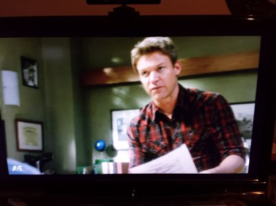

I have the quality set to high I don't see an option to 720p do I have to log in or have hulu plus?
No lag at all.
