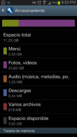

Hi everyone, i have the same problem, my phone has no more than 6 months with me, and the first issue that i had was that the external sd card slowly died, until now it's unreadable in any device i try it, but well i though, ok just buy another one of better quality, but recently no more than a couple of months ago, this little sucker has been jamming so much that today the only way to use it again is to take out thw battery, i'd been checking all the features and found something really interesting, it's very intriging so i will just add the printscreen so you can check it out, maybe it has something to do with the jamming, by the way this screen was taken just after i cleared all my photo and video folders, hope someone have some comments about this, i didnt do anything to the phone, not routing not anything strange
