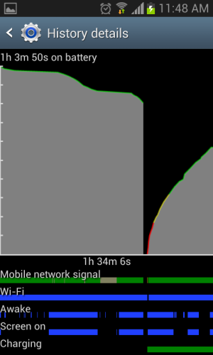

Hi!
I really appreciate your help. Since the last week mi S3 mini started to suffer from an unexplicable battery drain, to the point of not be able to restart again. I plugged to AC charger for a couple of minutes and the battery show a charge level similar to the moment before the event.
I found in several forums that this is a recurrent problem in this model, with some solutions focus on coexisting with the problem instead of solving it.
I did a factory reset and reinstalled all of my apps. When I open the Facebook or twitter app and used them for about 10 minutes, the phone shuts down. If I try to take a couple of pictures, the phone shuts down. Trying to do some web browsing with Google Chrome, the phone shuts down. But I plug the AC charger, a couple of minutes and everything is back to normal.
Last night I left my phone unplugged with a 56% of charge and 7 hours later, it was just 53% of charge. It seems like the problem is not in the battery.
It seems like the suspect is some kind of kernel update that keep crashing my phone, but I can't find how to rollback it.
Here some screenshots of one the events.
Really, really appreciate your help.

Re: Samsung Galaxy S3 mini unexplicable Battery drain
Welcome to Android Central! Do you know if there are any official OS updates for your model? If so, perhaps the update addresses this problem (although lately with Samsung, their updates sometimes cause more problems than they solve).
You could try rebooting into Safe Mode, which disables 3rd party apps. If the problem persists, then it's a system or hardware issue. If the problem stops, then it's a software issue related to something you installed. It can be a little difficult to do much in Safe Mode, however, since all of your 3rd party apps are disabled--but you can still use the phone and the browser. Here are instructions for the S3--I assume the steps are the same for the Mini:
Thank you for the advice, unfortunately none of them worked.
I installed Kies and performed a firmware update; I had the latest version but I did it anyway in case something was missing. Same results.
I restarted the phone in safe mode; by the way, it's the same procedure. Obviously none of the third party apps were available, just Google Chrome. I browsed a couple of web pages and then crashed again. I left the phone unplugged all the night and nothing happened. WiFi was active and several process were running during the night.
I have no choice but to buy a new battery and check if there?s something wrong with it. It seems that the crash occur when multiple process are running and the increase consumption of power causes this problem.
I let you know the progress of this situation.
thanks again for your support.

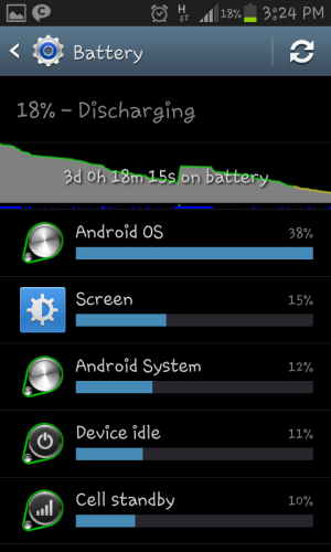

Sorry to jump into this tread. ..didnt want to start new one ...as i have similar problem.
My Samsung S3 Mini android 4.2.1 started to drain battery couple of weeks ago ....i have bought yesterday a new higher capacity battery...but ut still drains battery from 100% to 20% in less than 6 hours of ...dking nithing exept coupke of phone calls and few texts???...
I have installed DS Battery Saver ..with heave agressive profile and a Wake up Lock Detector...but bsttey still drains.....
Wonder what process in the background eats up power that fast?
any tips n twicks?
Thanks in advance for your help
