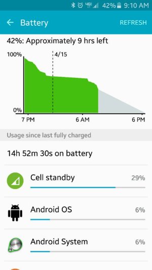

I know this has been an issue with some on T-Mobile draining their batteries.
What exactly is the intent of Cell Standby when it displays as a percentage of battery use? If you look at it literally it sounds like it's time when your cell radios are on standby awaiting to be used. Whenever I'm connected to Wi-Fi my Cell Standby starts counting up second by second. While at work today my cell standby was less 1% over 8 hours. Now at home on Wi-Fi it's up to 10% over the past 4-5 hours.
To me, this makes it sounds like it is reporting properly but why would it drain battery if Wi-Fi is connected and the cell signal is "on standby" whatever that really means. I'm just trying to wrap my head around what is wrong and what can be done short of never using Wi-Fi. I have unlimited data but that's besides the point. My battery is awesome if I turn off Wi-Fi completely but goes downhill fast when I turn on Wi-Fi.

As you're probably aware, this is a bug that is being reported on S6's on various carriers, not just T-Mobile. Check out this thread: http://forums.androidcentral.com/samsung-galaxy-s6/513541-cell-standby-battery-drain.html
It sounds like for some reason, when you're on wi-fi, the cell radio is inappropriately working overtime to get signal. If it has to do with wi-fi calling, then perhaps there's a glitch in the code where the cell radio thinks it needs to find a signal since it's no longer being used for calling. Hopefully, Samsung will fix this soon.

I'm on Verizon and I have the same issue and Verizon doesn't even offer WiFi calling. But if you're on TMobile and you don't use WiFi calling, it's worth a shot turning it off to see if it helps. I think Cell Standby includes the WiFi radio. When I use a 3rd party battery monitor (GSam), it shows that WiFi is the culprit of the large drain and not the Phone Radio which is listed as separate. If I keep off WiFi my battery is much better. Also, my battery drains extra fast when I have WiFi on but am not connected to a network. When I'm connected it appears to be less drain but still more than when just on LTE.

Very good explanation. Exactly what I suspect is going on. Not sure why it doesn't affect all phones (some people don't seem to have it at all) but T-Mobile confirmed for me there is an issue and they are waiting on a Google fix.

I have had Wi-Fi calling off since day 1.
My battery drain is worst when Wi-Fi is on and I'm connected to Wi-Fi.
It's normal when Wi-Fi is on or off and I'm not connected to Wi-Fi.
It seems my only option is to turn off Wi-Fi, which is not really acceptable.

I'm on AT&T...at home on Wi Fi and my Cell Standby was 21%. Hopefully they fix this soon.

Have you tried clearing the cache (volume up + power + home at same time) and then turn on Advanced Calling? Supposedly it helps slme people with this issue on Verizon. Can't tell if it's helping me or not yet. Cell standby is definitely down but can't tell if my overall battery life is helped.

I actually did it this morning. now after being at work all day where I'm on cell only - no cell stand-by drain....now back at home and cell stand-by is again at 13% and climbing. I called up Verizon support...they are not even aware of the specific issue other than "short battery life"....so the support agent made me go through applications and telling me that TuneIn or Spotify are battery drainers...I told her that that doesn't really have anything to do with the cell standby...but they don't have any KB article on that yet...but...she connected me with Samsung...
Talked to the Samsung Technical Support...I was told I could send in the phone for repair...I asked her whether they are actually aware of a battery drain issue for the S6 and she said, yes, they are aware of it and apparently are working on some solution..she then said that she couldn't tell me how long that would take though - she also said that they weren't sure whether it was a software only fix.....I said...well...I might just return the phone then since I can't do with 35 % battery drain over night...and she said...yes, that's what she would do as well ...oh well...not the answer that I wanted to hear...but that's likely what I'm going to do unless I hear before my 14 days are over, that there is a fix in the works with a tentative timeline.

Simple solution to this that works for me immediately:
Turn off WiFi calling and turn if VoLTE.
After I did that, I never again saw cell standby on the list of top battery usage.
VoLTE is turned off by hitting "more" on the phone app.

Cell standby is KILLING my battery! It was around 65% last night when I put it on vibrate and left it on for the night. This morning it was at 62%. It seems to not affect it much if not being used but it drops precipitously once being used. This is unacceptable and turning off WiFi is too!
Last night I did a restore on my phone hoping to cure the standby issue. I set up the phone as new and logged into my Google and Samsung accounts, connected to Wi-Fi and that's it. Nothing else. Disabled nothing and changed no settings. It auto-updated my apps.
Then I plugged in my phone. When it was fully charged I locked the screen and went to bed. I was expecting my battery to be at like 70 something odd % but when I woke up it was at 98%! No cell standby at all. I think restoring and starting fresh on 5.02 may have gotten rid of the issue.
Now to see if I have any weird drain after I download all my apps. I have a feeling that 3rd party apps may be bigger battery hogs than any of these settings fixes we all see posted. I'll keep you all posted on how my battery does today and if cell standby comes back tonight. It probably won't today since I can't connect to Wi-Fi.

I spoke too soon. When I woke up and looked at the battery stats there was no cell standby. But just now I looked and it showed Cell Standby at 3% and climbing now that I'm on a cell signal.
This is so frustrating because it's the opposite of what was happening yesterday.
Yesterday cell standby would increase when I was on Wi-Fi and not cellular signal and today it is increasing when I'm on cellular signal and not Wi-Fi!
