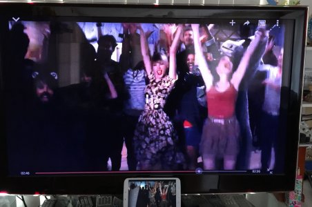

This is from a Galaxy Tab 3 8.0:
This is from a Galaxy Tab Pro 12.2
