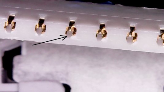

Actually it's not poor batch of batteries, this problem just comes from loose connection. Samsung fix this by using silver conductive glue. The battery is quite hard to be disconnected when they use this glue on the connector.

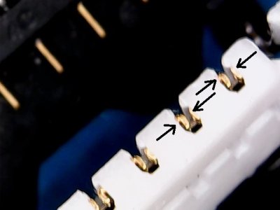

You can fix it by pushing the opening closer, no need to replace the battery
