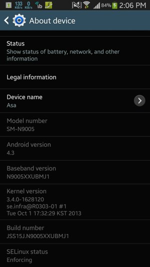

i have android 4.3 recently updated. i bought my note 3 at 11 november 2013 and since then i have been using my note 3 for wireless hd video streaming from my pc also . But all of a suddden seems like the wifi speeds getting high latency and now my speeed is very low on wifi . when my LAN pc is giving 10 Mbps download on speedtest with 7 MS . the note 3 gives 30 MS and 1 Mbps download and upload speed is giving burst of 1.41 Mbps . i am trying WAG 120 N DD WRT firmware and when i resetthe router and connect with no poasswords it gives rarely above 1.4 Mbps downlaod . but after that again the speeed is decreased . i have cleaned my DNS cache on android and switched off power saving mode and any other app which might power save my note 3 . Actually i used to get 2.2MBs from my WLAN pc . now it is restrsicted to 1 Mbps :(
i have mailed Samsung support also but so far no word. i would urge all to mail to samsung support so that they would hear us when they launched android 4.3 fimrware. Seems like 4.3 wasnt a good fimrware . there are many bugs .Everyone try to message their facebook samsung pages of uk india usa and other pages in facebook. and mail to their websites also .
Please check my screen shot of my latest version and speedtest screenshot
