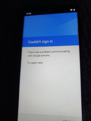

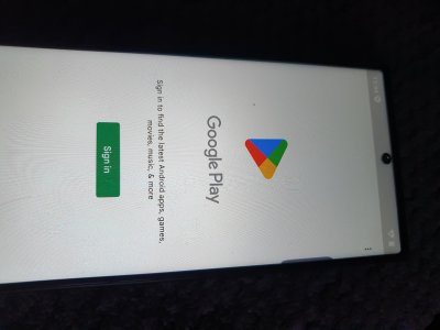

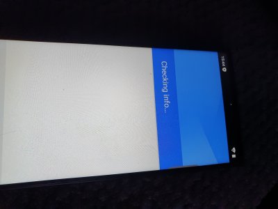

I have just bought Samsung s24. I am having problems doing anything with it, I can't get onto Google at all. I have reset the phone loads of times. I can't update anything as I can't get onto play store.
Have attached a pic.
Any ideas please as at the moment it is a piece of junk. I can't transfer any data or anything, can't up date anything.20241123_094430.jpg20241123_094437.jpg20241123_094805.jpg
When you got this phone, did you have to set it up like it was a brand new phone? If so, did you have any issues setting it up with your Google account?
Where did you get the phone? Are you certain it's a legit Samsung phone? There are a LOT of fake knockoffs on sites like Wish, AliExpress, and even Amazon.

Yes brand new phone still in the box. I am beginning to think it is a knock off. How can I tell please. Thank you for replying

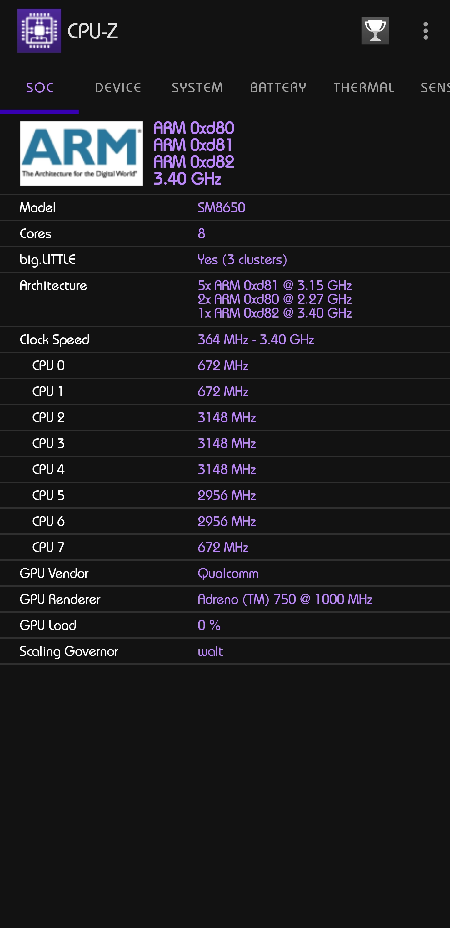

Try running a couple of different device info apps, and see what they report. I suggest Device Info HW and CPU-Z. The biggest giveaway is usually the CPU -- the S24 should have the Qualcomm Snapdragon 8 Gen 3 or the Samsung Exynos 2400 (depending on the region that phone was intended for). If the app reports anything else (often Mediatek), then it's a knockoff.
Show us some screenshots of those tests (primarily the screens that show the important hardware, like CPU, RAM, internal storage, etc.).

Here's how CPU-Z shows my Snapdragon S24 Ultra.

It won't let me down load it. I am in Bulgaria and we pay at the couriers office, I have put a claim in there as the then pay the money to the sender.
Hmm, I guess if you can't log into the Play Store, you won't be able to install apps from the Play Store.

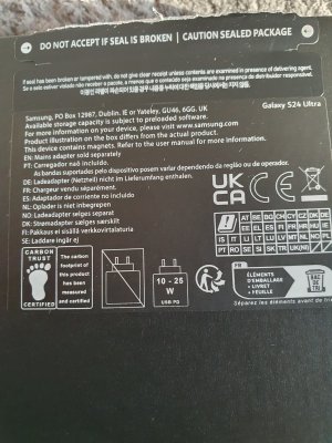

Do you still have the box the phone came in? If so, take a picture of the fine print on the back of the box and show it here. Knockoffs often have a lot of obvious typos.
Pic of back of box.

@stella999, that looks pretty normal, but sometimes knockoffs can be pretty good at reproducing all the details.
I asked this a couple of times before, but didn't quite get a definitive answer: when you first turned on the phone for the first time right out of the box, did you have to go through the whole setup wizard, where it asked you to sign in to the phone (not the Play Store) with your Google account, and then asked you if you wanted to copy data over from another phone, or restore from a backup on Google Drive?
When I look at those initial screenshots you shared, that UI looks pretty outdated, which increases my suspicion that this is a knockoff.

I think it might have asked to set up my Google account which I tried to do, that is now just stuck in a loop now. Have tried WiFi and with sim for mobile data. It is a fake, I know it is.

Unfortunately, you can't just install a different version of Android on the phone. Someone would have to design a custom ROM for that specific phone, and that's not going to happen with generic knockoff clones.
If you bought the phone on some online marketplace, see if there is an option to dispute the purchase. eBay is very good about this, and typically protects the buyer more robustly than the seller. But if you bought this as a private transaction, then the seller really has no obligation to do anything, unfortunately.
Most likely, this will just have to be a hard lesson learned. Cheapo knockoffs of flagship phones are rampant online, so it's always best to buy from reputable sources (or at least use a marketplace with good protection for the buyer). One of the most obvious clues is the price -- if the price seems too good to be true, then it's almost certainly not true. Refurbs for the S24 Ultra still go for around $700, so if you paid closer to $100-200 for it, that's a big red flag. Sorry!
