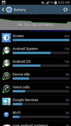

I know that you guys get these questions a lot, so I'm gonna make it easier by saying I did the whole disable-what-you-don't-need method and I'm left to 2 options:either root my phone and save battery by manipulating stuff in advanced mode like my cpu OR just buy a new battery since my phone is a year old. Here's my battery summary pic (this is with battery doctor which helped save my battery a little)

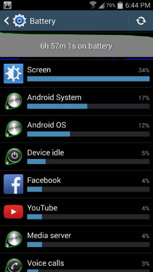

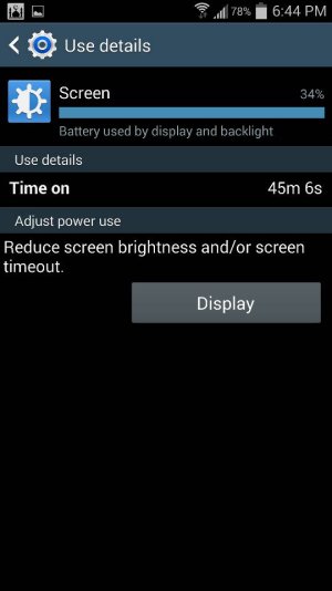

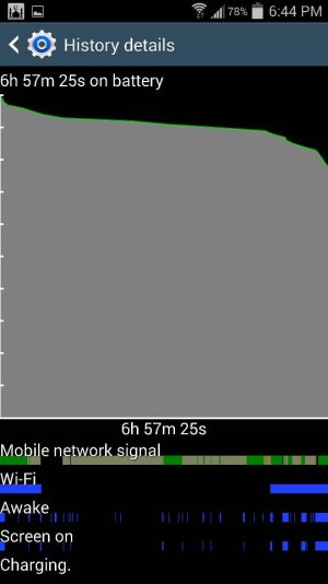

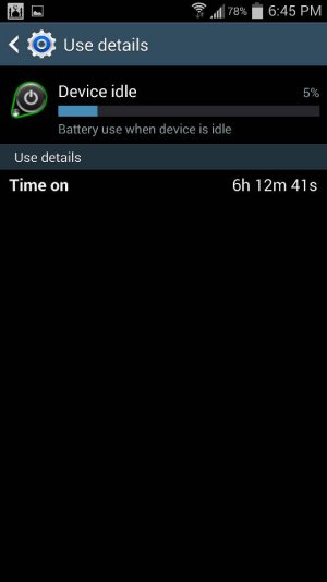

Okay here are updated pictures. I'm not sure if you meant idle time when you said Cell Standby so I screenshotted that.
Ok, that's a start. It would still be better if you let it go from 100% to about 20-30% with normal usage, then show us those screens. This will give us a better idea of what is using battery over the span of a single charge, rather than just a small fraction of that charge.

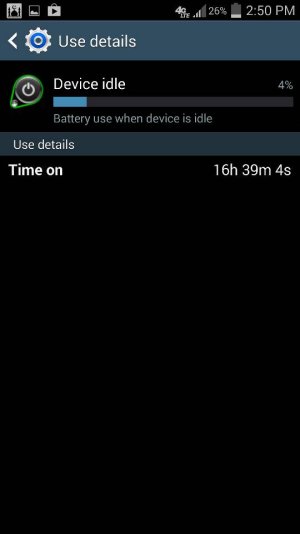

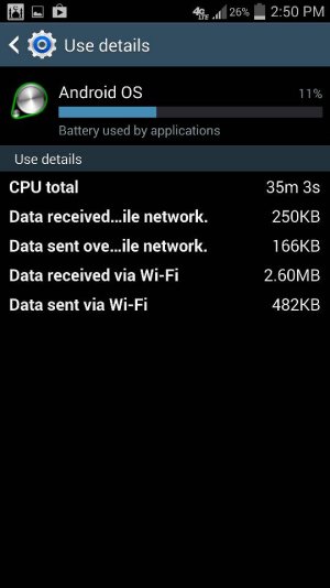

Okay NOW I'm ready

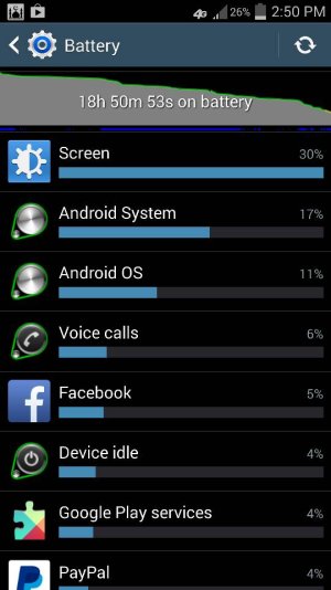

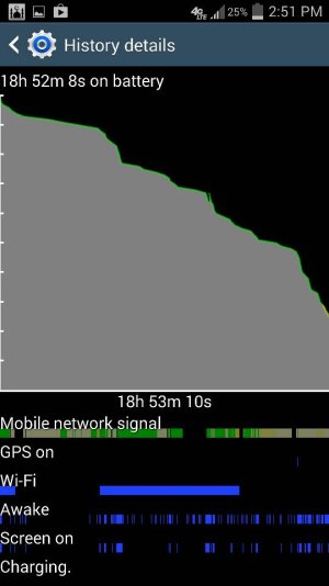

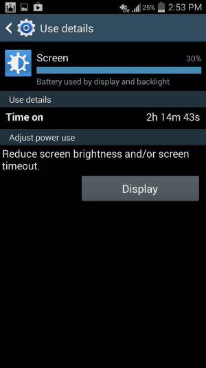

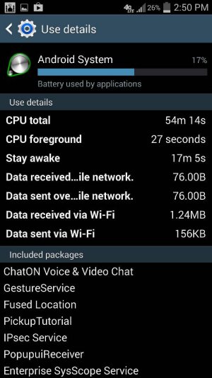

That does seem relatively short battery life. The cell signal doesn't always look great, so that might be part of it. I think the S4 should get around 4-5 hours of total screen-on time per charge, depending on usage, and you're not on track for that. Otherwise, nothing else really stands out. The Android OS and Android System percent usage seems normal to me.

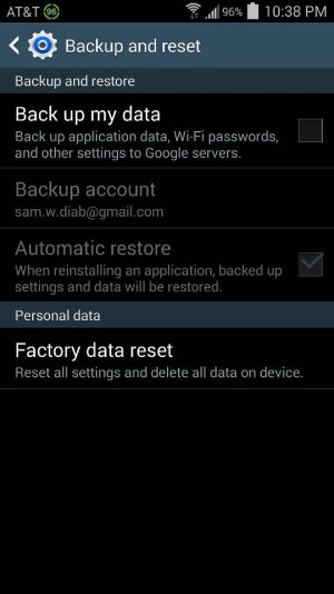

You mean a factory reset? I've done that multiple times before
No, a cache partition wipe isn't as drastic, and is achieved through the Recovery Menu (see that link I included above). It won't hurt to try it, but I think a factory reset would have also wiped the cache as well.
