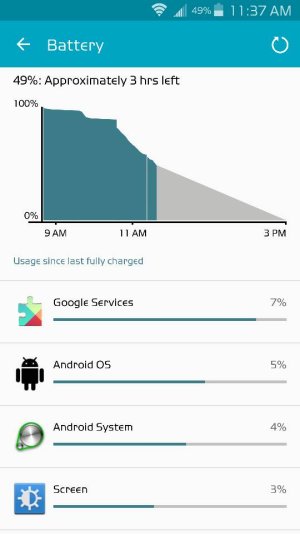

To all you guys saying that your battery usage graph says that you are only going to have a few hours of battery life; how long did your battery actually last? When I checked mine yesterday morning it was giving me 3 hours of usage. At the end of the day(about 14 hours) I had 26% left.

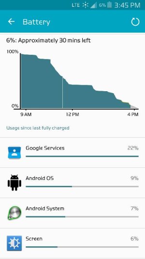

I had the exact same problem. I ended up backing up all my data and doing a factory reset (doesn't revert back to KitKat - clean Lollipop only). It solved the OS problem (was using a large percentage of the battery just like the picture posted by another user). Anyways, my phone was getting extremely hot and the battery was still draining (although not as quick). I disabled all the Amazon apps and a few others (Amazon, Amazon app suite, Kindle, Amazon MP3, IMDb, NFL Mobile (Verizon), and Softcard). I'm no longer having the issue. Honeslty, I think it was the Softcard app, but seeing as how I don't use any of the others, I went ahead and disabled them also.

Battery sucks since update. Phone is hot all the time. 1/2 day use now compared to full day.

My battery is shot at 3:45. Never have I had a battery dead at this time in the day.
