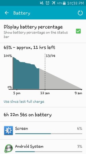

My s5 was actually going great on Lollipop until recently when it the battery drains fast with screen on (5-6 % in a matter of minutes). Checked battery stats with Gsam and nothing out of ordinary. My android OS is high (17% or higher) but all other apps are almost insignificant in Battery usage. I did install MI Fit for the MI Band and have enabled the notifications but the battery stats show it as using, at most 2% battery.
I have to agree with you. I also believe the lollipop OS drains the battery more than kikat did.

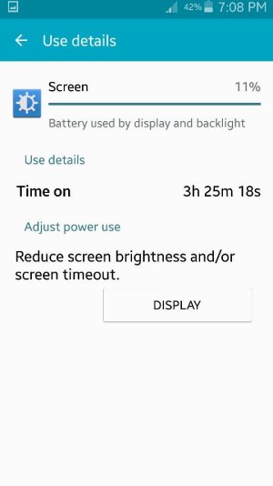

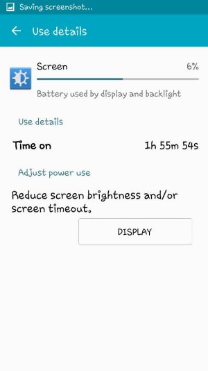

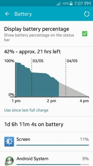

quite satisfied with mine
