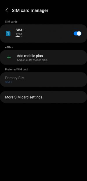

Well my Att sim i swapped in my unlocked Note 20u it has esim and my TMobile in my unlocked Fold³ notScreenshot_20220208-212601_Call%20settings.jpg

You can use odin to update Xaa,VZW ,TMB all gave same firmware just make sure in ODin slot CSC use firmware Home CSC
Im on TMobile unlocked haven't noticed connection issues
Thanks. I checked XAA and shows version ending in BULA, which is what I currently have. I think there is a newer version?
Will the ATT version work on Tmobile unlocked?
Yes , i gad my Att sim at the time the OtA hit my device then i just recently put my TMobile sim .
If its out in frija only TMB/Xaa/Vzw is available can check SamMobile if they have att but they all the same any will work and continue getting ota
