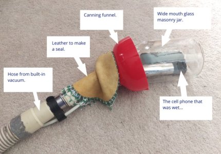

Thanks for the idea of putting the phone in low pressure to get the water out - that just saved my phone!
I'd dropped it briefly in water, and after drying it in rice and on a cold air vent for hours, the screen still would not show reliably, cutting in and out when powered on.
After seeing your advice about a vacuum pump, I rigged up something simple at home and it worked well. After an hour or two, the phone worked!
