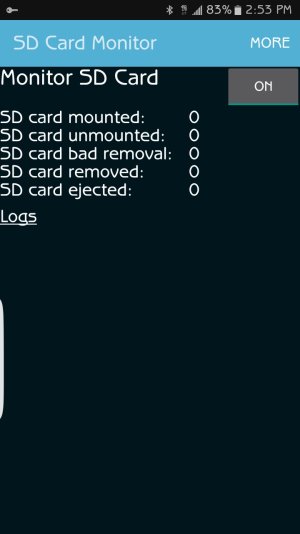

Have you tried using the SD Monitor app to see if the card is still ejecting/unmounting? It's looking more and more like all the update did was hide the massage from popping up but the actual problem is still occuring.
I tried to install it now and will check to see what happens.
I rather not install another app if not needed.
You may not have to install an app. When the SD card un/re-mounts, the Media process (re)scans all the media on the card (which drains the battery, which is my peeve with this bug). So you may be able to check the percentage of battery used by the Media process, and if it's unusually high, it could be because the SD card is un/re-mounting in the background.

SD Monitor NEVER showed me unwanted ejected SD Card, which surprised me a bit. I also never had upcoming notifications. Nevertheless I experienced freezes when downloading my Spotify library to the SD Card. After listening to two or three songs, Spotify would freeze.

Honestly, neither one of my T-Mobile S7 Edge phones have this problem. I frequently listen to music and go through pictures to post on FB and other sites at the same time. My phone has never frozen and SD monitor is always at 0. I have owned these two phones for over two months now. They are perfect.

I was streaming music to my home audio system while looking at pictures as well as saving various things to my sd card for well over 2 hours on Sunday with 0 issues. I actually listen to music and browse other things, including pictures, at the same time quite often. The only time I get the message is at boot. This is a far cry from my original s7 edge that gave me the notification constantly. I don't get any errors when using the camera or any other app at all. I've taken my sd card out put a different one in with the same result. I've cleared cache from the recovery screen as well as settings with no issues either. Just my experience that I've had on my replacement. And the sd card app has shown 0 unmounts as well.
