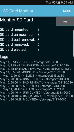

My 4 day total. :p At least I had one day with no bad dismounts. :-\
4 in 4 days isn't too bad. I was getting like 30 a day, with the first handset. I've gotten zero in, 3 weeks, with the replacement. (knock on wood).

I also have the app SD Card Monitor. It disconnect like 12 times per week. Sometimes at 5am (when I sleep). Most of the time is Cam and Gallery, but sometimes its even listening music. I am at my third phone and this is a MAJOR default. I do believe its a hardware one and not software related.
