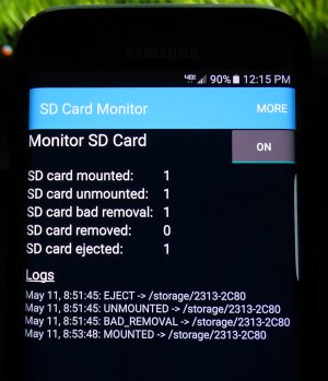

Installed the SD Card Monitor on my S7 Edge and so far so good.
I'll report back tomorrow and see how it goes. This is the Verizon S7 Edge with the May 1st update.
Ok still no problems with the sd card ejecting looking at the sd card app.

That is interesting. If no SD card is present in the tray, then it sounds like it could be a software issue if the notification continues to appear.
Less than 24 hours after installing the SD Card Monitor app and I've still got problems. :(
This is on a Verizon S7 Edge with the May,1st 2016 update.
All they did was eliminate the pop up and not fix the actual problem.
I guess it just might be a hardware problem after all with the S7. :(
