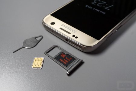

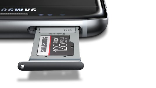

AFA the trays. I'll admit I do not want to remove the tray just yet. I did find some pictures online which show the differences I saw, though:
This first one represents the fit on the first SD tray. There is room for the card to move around.
This one is representative of the replacement handset's tray. Kind of hard to see. Notice how there is no wiggle room.

Thanks you for sharing. I'm going to go out on a limb and say that this explains the inconsistencies. I'm not sure how precise SD cards are manufactured, but I think it's safe to assume there are very subtle variations; even across the same brand. That said, it would stand to reason that different cards "fit" into the trays differently.
The good news: If that's the case, we don't need new phones: just new trays. The not so good news: my experience with Samsung is that they NEVER own their defects, so it might be an uphill battle.
